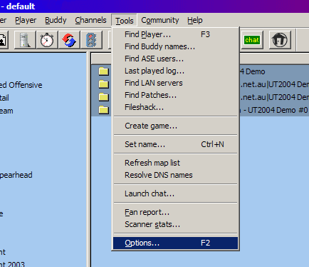

Start the The All Seeing Eye software.
From the "Tools" menu, select "Options" (or just press F2) as in the image below:

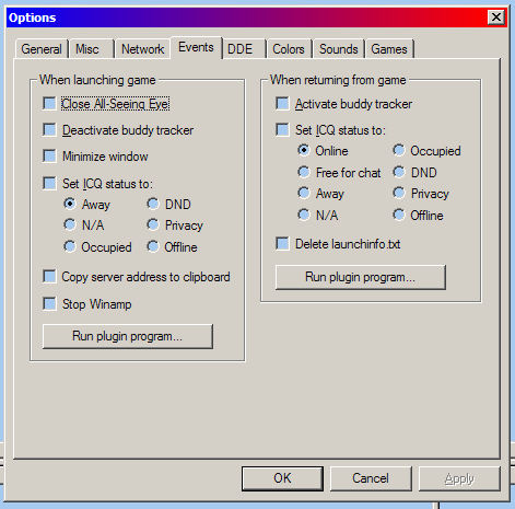

In the options dialog, select the "Events" tab:
In the "When launching game" box, click the "Run plugin program" button.

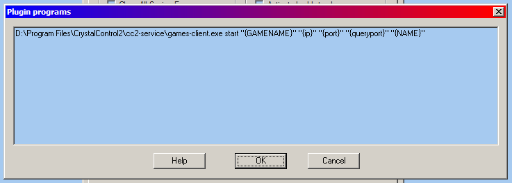

A window will appear with a blank text box. In this text box enter the exact text below, modified for the directory in which you installed CrystalControl2.
<your-CrystalControl2-directory>\cc2-service\games-client.exe start "{GAMENAME}" "{ip}" "{port}" "{queryport}" "{NAME}"
For example, if you installed CrystalControl2 in the "d:\program files\CrystalControl2" directory, you would enter in the following:
Click the "OK" button.
Now in the "When returning from game " box, click the "Run plugin program" button.

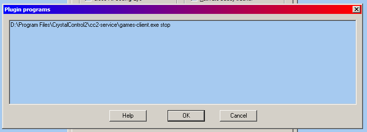

Enter in this text:
<your-CrystalControl2-directory>\cc2-service\games-client.exe stop
Like in this example:
Click the "OK" button, then close the options window.

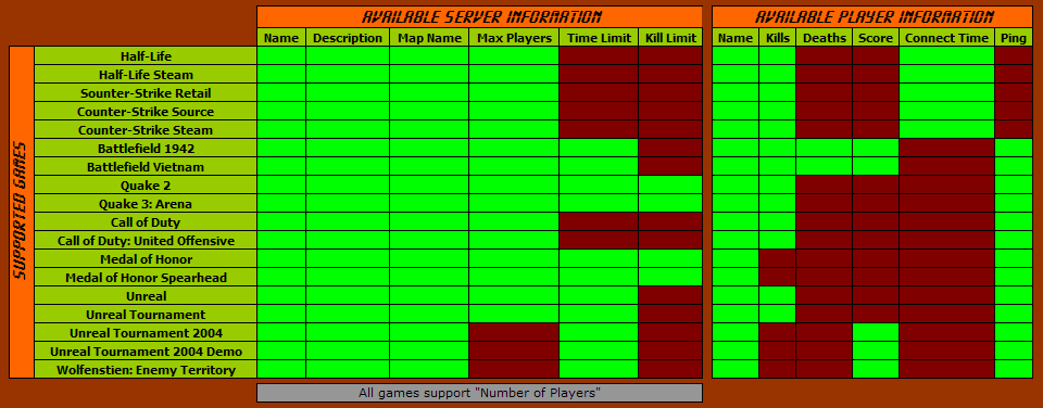

Supported Games
Below is a list of supported games, and the information that is available for each.
