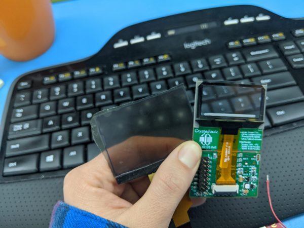

A few caveats before we get much farther. First, doing this will definitely void your warranty on the display. Second, the display we’ll create is significantly less transparent than a transparent OLED display as you can see in the above image with the hacked transparent display on the left and the transparent OLED on the right.
