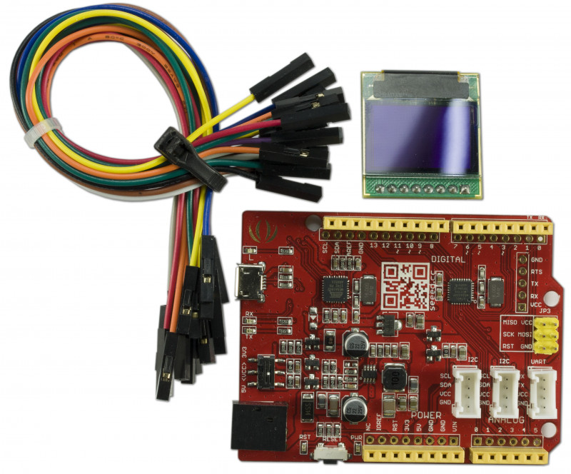

Crystalfontz CFAL9664BFB1-E1-2-displayCrystalfontz CFAL9664BFB1-E1-2-display

One of the first tasks is to choose the interface you want to use. The most popular interface for small displays is SPI. SPI is great because it only uses a few lines.
Here are some typical SPI display lines:
  • SCK = SPI Clock — shared with other SPI devices
  • MISO = Master In, Slave Out (not needed on all displays) — shared with other SPI devices
  • MOSI = Master Out, Slave In — shared with other SPI devices
  • nCS = Chip Select. When this line is low you can talk to the display
  • D/C = Command / Data. When this line is high, you write to the display’s data register. When this line is low, you write to the display’s command register.
  • nRES = Reset. Drive this line low to reset the display’s controller. Keep it high for normal operation.
So SPI only takes 6 lines, three of which can be shared with other SPI devices, like a uSD card.
