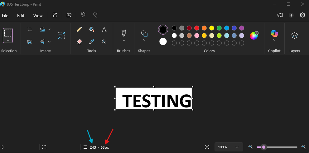

Image from Computer. Open the photo in Paint
I am going to just use a simple TESTING text in paint to demonstrate how to convert and show on your display.
- Open photo in Paint
- Make sure it is smaller than 244×68 Pixels
- Save it as Monochrome Bitmap (.bmp)

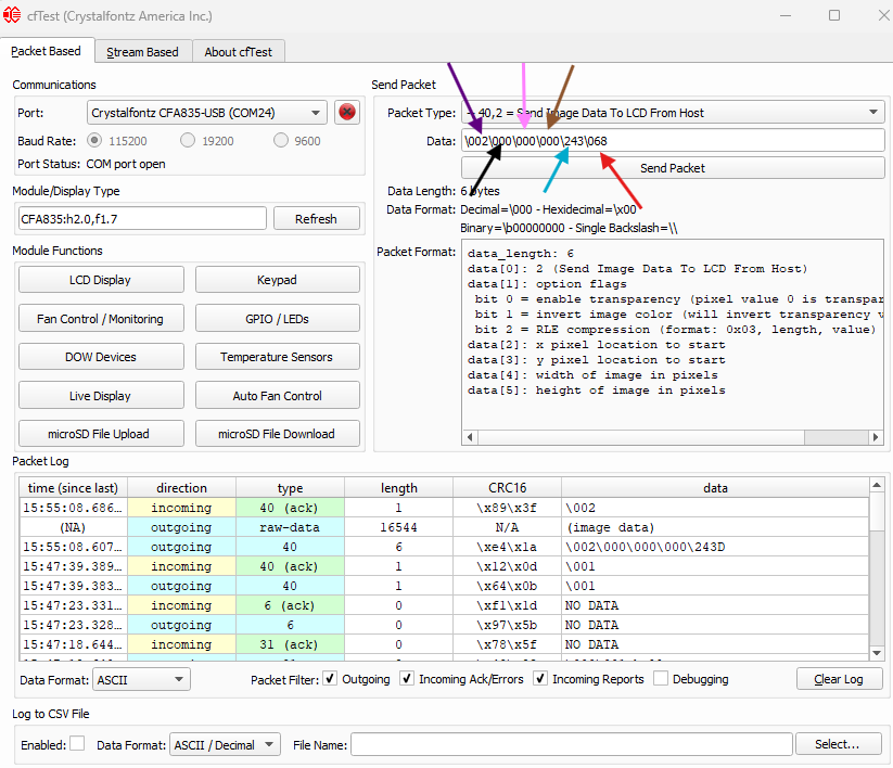

Sending the Photo to the Display
- Open the port to the display
- Choose Packet type of 40,2 = Send Image Data to LCD from Host
- In the Data field there needs to be a string similar to the one I have provided int he photo.
- Each color of arrow is a different item
- Purple – Is data 0 – Send image data to lcd from host
- Black – Option flag ( i chose transparency)
- Pink – X pixel location start I did 000 to start left side
- Brown is – Y Pixel location start I did 000 to start on the top
- Blue – is Width of image in pixels, this must match your photo (blue arrow on photo above)
- Red – Is height of image in pixels, this must match your photo (red arrow on photo above)

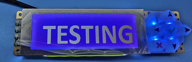

Viewing the Photo on the Display
- Click send packet
- Navigate to the location on the photo
- Click the photo
- Click open
- Your photo will now be displayed on the display
