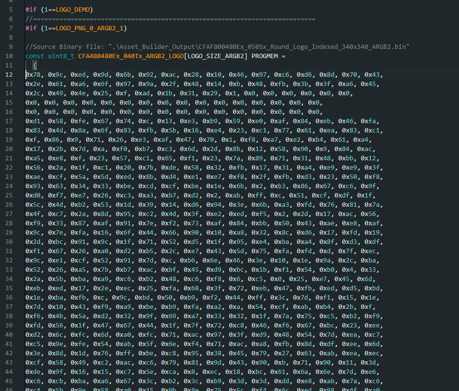

Open the generated .c file. It will have your array and call out the array size.
Copy the array into Round_logos.cpp.
This is the ARGB2 logo.
To make the PNG logo, simply drag your PNG into the BIN2C Input Box and hit compress. Then copy the output array into the variable called xxxx_PNG_Logo.
Make sure you also update Round_Logos.h with the correct array sizes (your array sizes may be different, but these are the sizes for the image I used):
#define LOGO_SIZE_ARGB2  (2480)
#define LOGO_SIZE_PNG  (4927)
