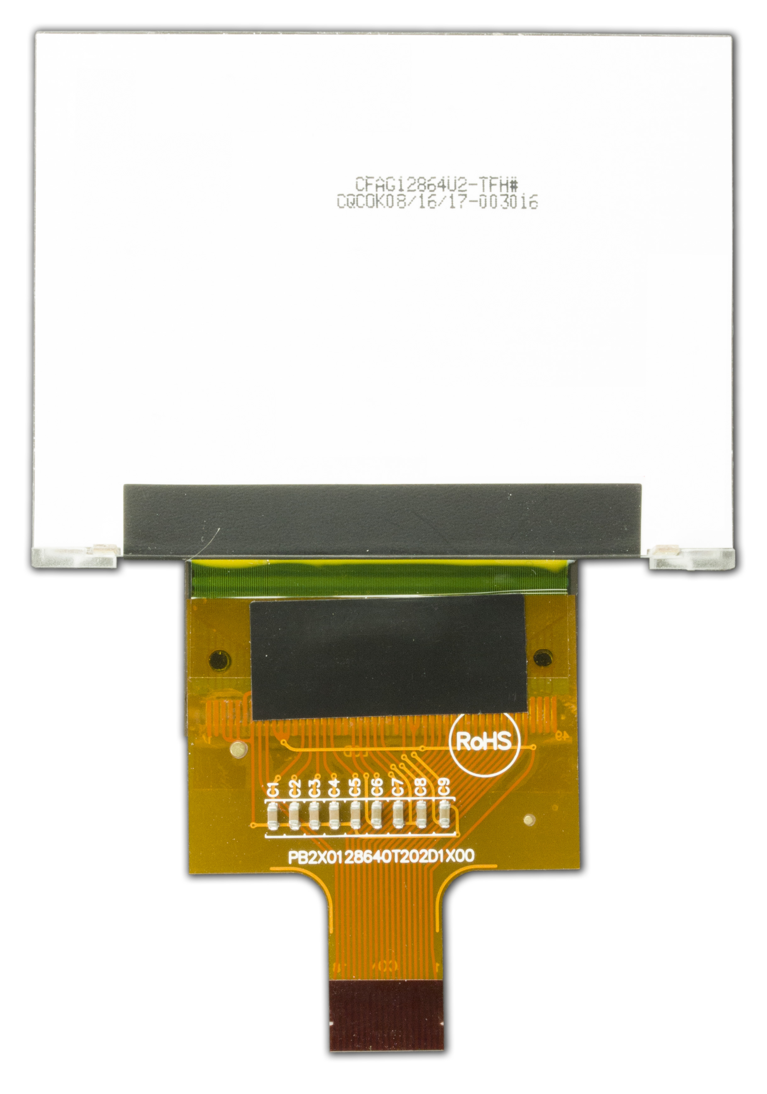

    The bendable area of the tail is marked by 3 green lines. On the old parts, the controller chip was mounted 5.5mm from the third green line. On the new tail, the controller chip is mounted 2.5mm from the third green line.
    Impact: For many applications, this change will not affect production. Please ensure that your application does not put undue force on the connection between the flex and the LCD glass. Please ensure that there is not undue bending or force on the flex in the area of the hard, inflexible chip.
