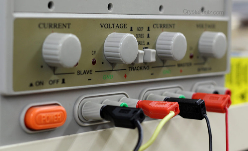

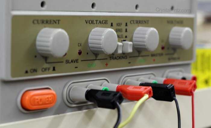

Bench Power Supply
The bench power supply is used during LCD testing to supply voltage to the modules while limiting current — so no damage occurs if there is a fault in the module.

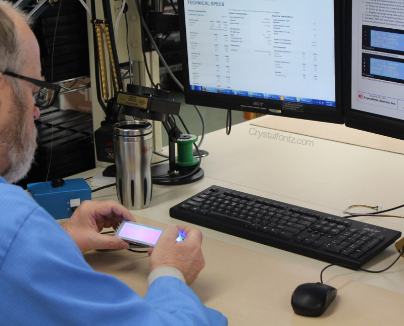

Testing station 1
Each station has dual monitors with the testing steps and requirements for each series of modules. The Crystalfontz firmware is loaded on each module in this step.

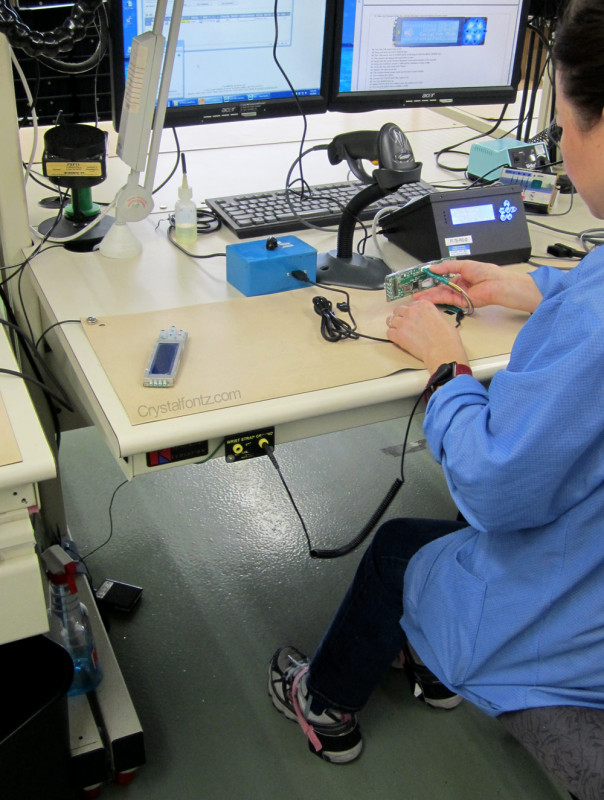

Crystalfontz Production Line - static guards
Electrostatic protection
Electronics such as LCDs are electrostatic-sensitive devices. This means that the static that builds up in people, buildings, and tools can damage a module if ‘shocked’ with static.
We take great care to prevent damage to LCDs due to electrostatic charge. In the photo above, note the conductive flooring, desk mat, wrist guard, shoe guard, and blue lab coat — all designed to prevent electrostatic problems.

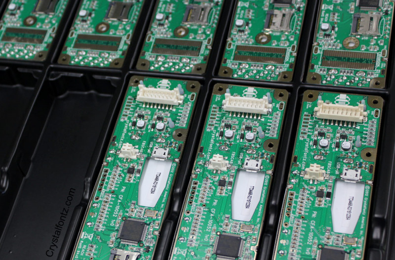

Crystalfontz Production Line - LCD modules that passed inspection
Modules That Passed Specifications in the Production Line
Additionally, our LCD trays (above) are coated to prevent static build-up.

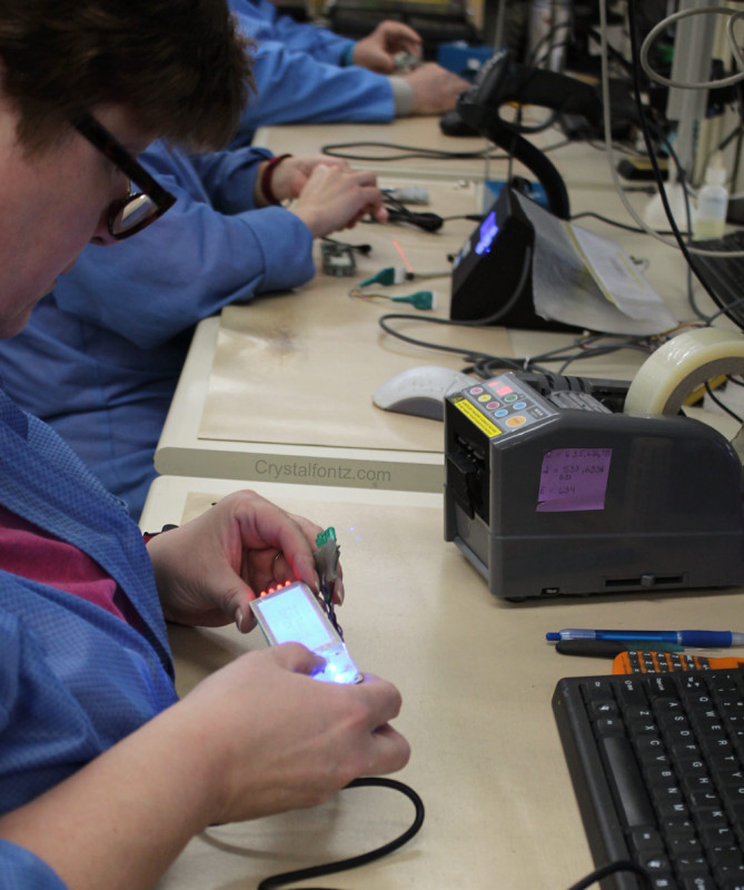

Crystalfontz Production Line - testing LCD modules

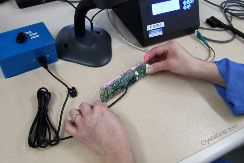

Powering Up
Modules are powered up several times and run through a series of tests to ensure the firmware is functioning as it should.
