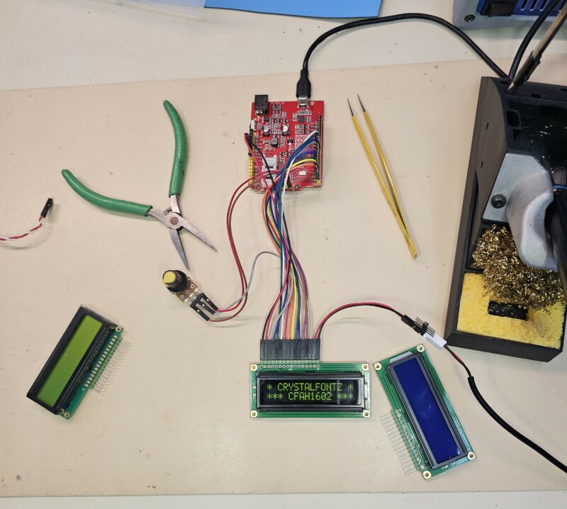

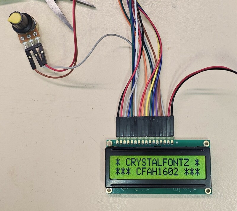

🛠 Part 1: Wiring the LCD to the Microcontroller
Use the 4-bit mode for simplicity (fewer wires). Here’s the basic wiring chart:
| LCD Pin | Function | Connect To |
| 1 (VSS) | Ground | GND on Seeeduino |
| 2 (VDD) | +5V Power | 5V on Seeeduino |
| 3 (VO) | Contrast | Center of 10k pot |
| 4 (RS) | Register Select | Pin 12 |
| 5 (RW) | Read/Write | GND (write only) |
| 6 (E) | Enable | Pin 11 |
| 11-14 | Data Pins D4–D7 | Pins 5, 4, 3, 2 |
| 15, 16 | Backlight | 5V and GND (optional) |
🧠 Tip for students: Always double-check connections before powering the board. Reverse polarity can damage the display!
