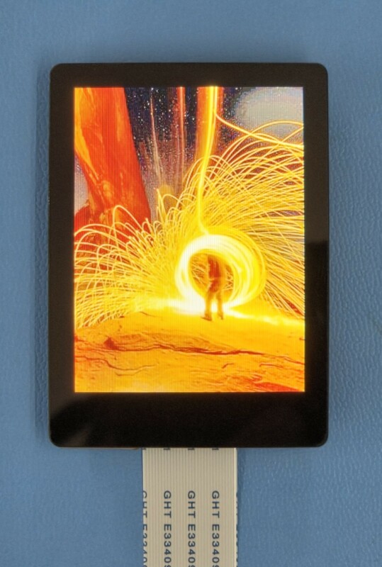

When selecting a display for your next product or project, choosing the right LCD technology can make or break user experience. One of the most important technologies to consider is IPS (In-Plane Switching). Known for its excellent color accuracy, wide viewing angles, and consistent image quality, IPS has become the standard in many consumer, industrial, and medical applications.
But how does IPS TFT screens compare to other TFT LCD types, and when should you use it? Let’s dive into what an IPS TFT LCD is, how it works, and why it may be the right choice for your next project.
What is IPS in LCD Technology?
IPS (In-Plane Switching) is a type of LCD panel technology where liquid crystals are aligned parallel to the glass layers instead of twisting or standing vertically. When voltage is applied, the crystals rotate within the plane, allowing light to pass through in a more controlled and uniform way.
This unique arrangement provides:
- Wider viewing angles – up to 178° horizontally and vertically.
- Accurate, consistent colors – images remain true to life.
- Improved clarity – text and graphics stay sharp, even off-center.

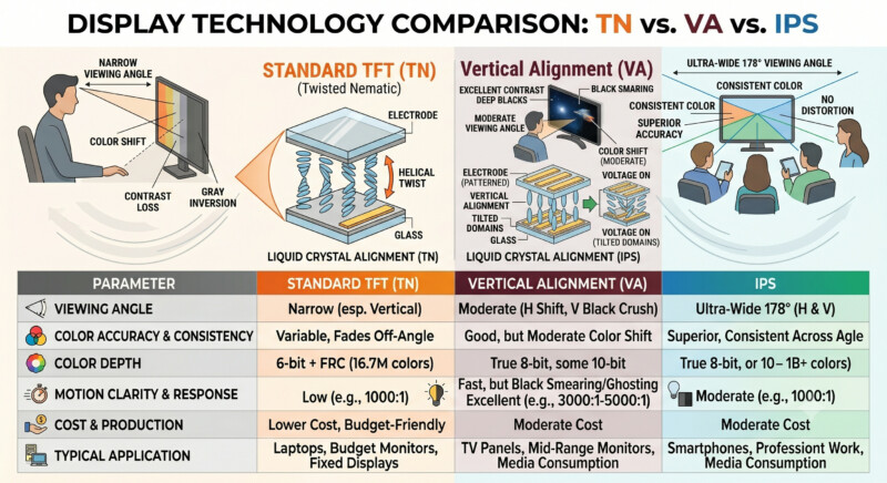

IPS vs TN vs VA: Which Should You Choose?
When selecting the best IPS TFT LCD, TN, or VA panel for your product or project, it’s essential to compare these technologies side by side:
| Feature | IPS (In-Plane Switching) | TN (Twisted Nematic) | VA (Vertical Alignment) |
| Color Accuracy | Excellent | Limited | Good |
| Viewing Angles | Wide (178°) | Narrow | Moderate |
| Response Time | Moderate to Fast | Very Fast | Moderate |
| Contrast Ratio | Good | Fair | Very High |
| Cost | Higher | Lowest | Moderate |
| Best For | Industrial devices, handheld instruments, medical imaging, automotive dashboards | Budget-friendly devices, simple handhelds, low-power gadgets | Applications needing high contrast like aerospace instrumentation |
Key takeaway: If color accuracy and wide viewing angles are top priorities, IPS is the best choice. For budget projects, TN may suffice. If deep contrast is critical (e.g., aerospace instrumentation), VA could be an option.
