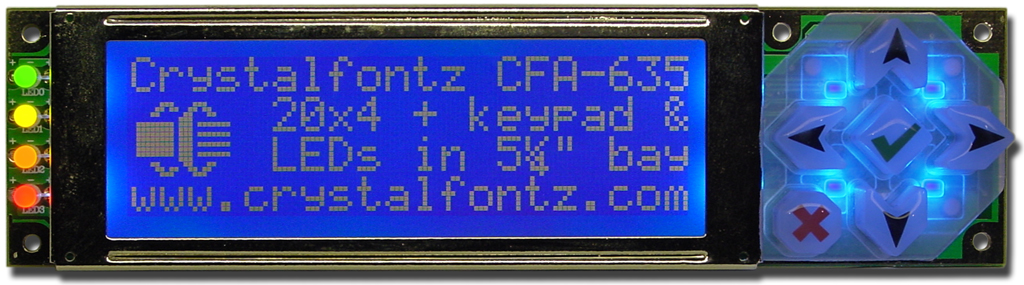

[EOL] 20x4 RS232 Character LCD
Part Number: CFA635-TMF-KS
Full-Swing RS232 Serial 20x4 character LCD module, Keypad, White Edge LED Backlight, STN Negative, Blue, Transmissive 0°C to +50°C operation, and 12:00 viewing angle.
  • LED backlit 20x4 LCD

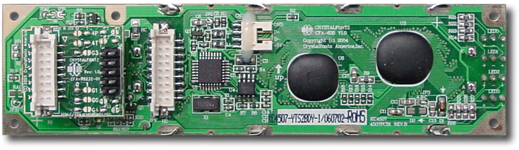

    Description: The CFA635 series of advanced display modules will be changing from the previous hardware revision 1.2 to the new hardware revision 1.5.
    Reason: As part of our continuous improvement, the processor and PCB layout have been changed to improve availability, manufacturability, and quality
    TMF series modules will become TML series.
    TFE series modules will become TFK series.
    YYE series modules will become YYK series.
    The CFA635 series now supports a single FBSCAB. The SCAB is no longer supported:
    Maximum temperature sensors is 16.
    ATX power supply control functions previously supported by J8 on the SCAB are now supported by H1 on the CFA-635.
    The backlight driver is a constant current design-the backlight current and brightness are now insensitive to supply voltage variations.
    The yellow backlight of the CFA635-YYK series is redesigned to improve brightness.
    ATX functions supported by J8 on the SCAB are now supported by H1.
