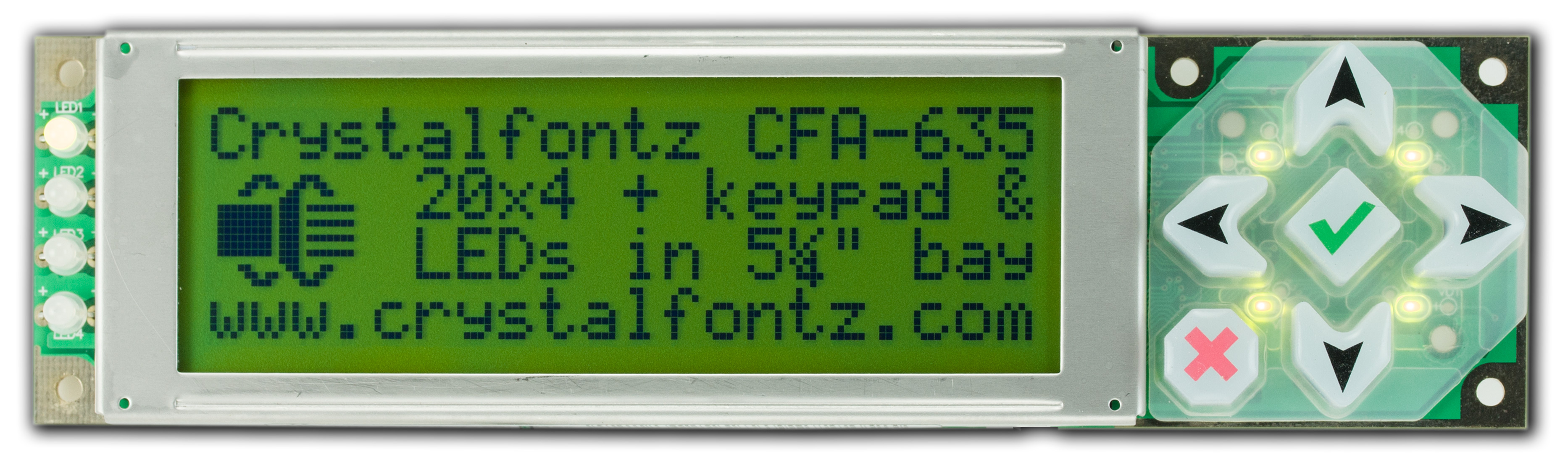

20x4 Serial Character LCD
Part Number: CFA635-YYE-KL
TTL / Logic Level (0-5v) Serial 20x4 character LCD module, Keypad, Yellow/Green LED Backlight, STN Positive, Yellow/Green, Transflective, 0°C to +50°C operation, and 12:00 viewing angle.

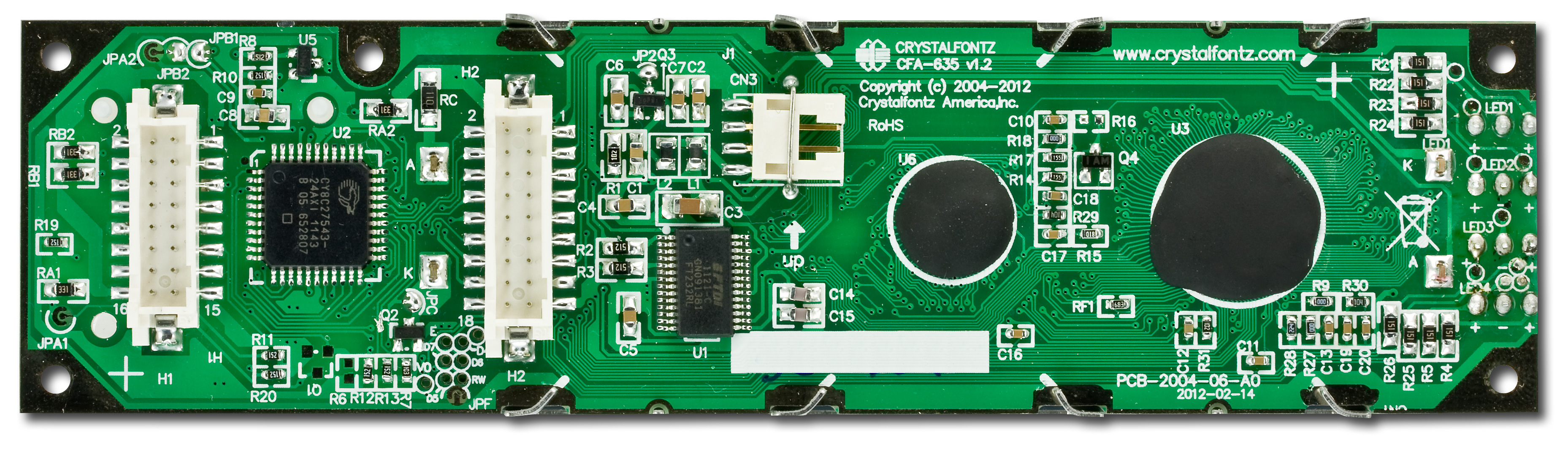

  • text_snippetPart Change Notice #10852: CFA635 series Hardware revision 1.5
    Products Affected: CFA635-YYE-KS, CFA635-TMF-KS, CFA635-TFE-KS, CFA635-TMF-KL, CFA635-TFE-KU, CFA635-YYE-KL, XES635BK-TFE-KU, XES635BK-TMF-KU, XES635BK-YYE-KU, CFA635-TMF-KU, CFA635-YYE-KU
    Date Issued: May 3, 2017
    Last revision: 1.2
    Description: The CFA635 series of advanced display modules will be changing from the previous hardware revision 1.2 to the new hardware revision 1.5.
    Reason: As part of our continuous improvement, the processor and PCB layout have been changed to improve availability, manufacturability, and quality
    TMF series modules will become TML series.
    TFE series modules will become TFK series.
    YYE series modules will become YYK series.
    The CFA635 series now supports a single FBSCAB. The SCAB is no longer supported:
    Maximum temperature sensors is 16.
    ATX power supply control functions previously supported by J8 on the SCAB are now supported by H1 on the CFA-635.
    The backlight driver is a constant current design-the backlight current and brightness are now insensitive to supply voltage variations.
    The yellow backlight of the CFA635-YYK series is redesigned to improve brightness.
    ATX functions supported by J8 on the SCAB are now supported by H1.
    Serial Versions (KS) - CFA635 h1.5,f2.1
    USB Versions (KU) - CFA635 h1.5,f2.1
    The command set, fan electrical specifications, temperature electrical specifications and mechanical dimensions are unchanged.
    If your application uses ATX power supply control, fan control, or temperature measurement through the SCAB, you will need to change to the equivalent FBSCAB components.
    Availability: CFA635 hardware version 1.5 will begin shipping in the second quarter of 2017, after the inventory of version 1.2 is depleted.
