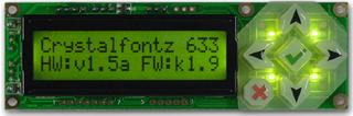

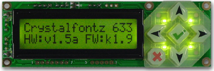

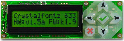

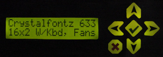

This product is discontinued and has been replaced by CFA633-YYH-KS
16x2 RS232 Character LCD
Part Number: CFA633-YYB-KS
CFA-633 (v1.5c) Serial LCD 16x2 +Fans +Keypad, RoHS Compliant, Yellow/Green LED Backlight, STN Positive, Yellow/Green, Transflective 0°C to +50°C 6:00
  • Four fan connectors with RPM monitoring or variable PWM fan power control.

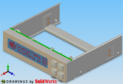

  • Available in a 5.25" half-height LCD drive bay kit, (see mounting bracket photos).

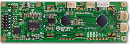

  • text_snippetPart Change Notice #10283: We will be phasing in the CFA-633 hardware version v1.5c over the next few months as the inventory of v1.5a modules is exhausted.
    Products Affected: CFA633-YYB-KS, CFA633-TMC-KS, CFA633-RMC-KS, CFA633-YYB-KU, CFA633-TMC-KU, CFA633-RMC-KU
    Date Issued: August 12, 2010
    Summary: We will be phasing in the CFA-633 hardware version v1.5c over the next few months as the inventory of v1.5a modules is exhausted.
    Last revision: 1.5a
    Description: The currently shipping version of the CFA-633 hardware is v1.5a.
    Here is a list of the changes between v1.5a and v1.5c:
    * Changed from black painted steel plated bezel to stainless steel bezel. Your front panel bezel should hide the bezel, so this change should not affect the appearance of your product. If your product design exposes part of the CFA-633's black bezel, that area will now show as stainless steel.
    * Increased keep-out clearance on PCB around the mounting holes.
    * Minor PCB layout changes.
    * Some factory configuration jumpers have changed.
    Please see the document linked here for photographs showing the difference:
    CFA633_v1-5a_to_v1-5c_changes.pdf
    Impact: The v1.5c should be a drop-in replacement for any v1.5a application.
    Recommendation: If you currently have a semi-custom part number based on v1.5a, we will need to issue a new semi-custom part number based on the v1.5c platform.
