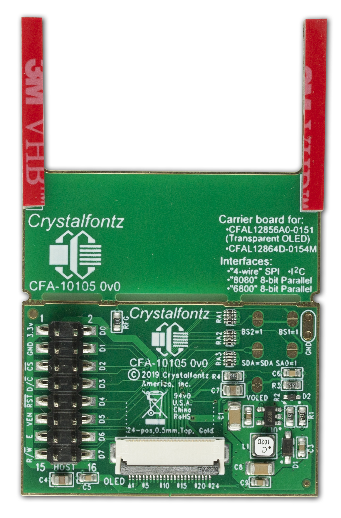

2. Check that none of the wires have come loose. A pin table can be found in the getting started guide.
3. Check that the display is in the breakout board correctly. The shiny pins on the display tail should point up when placed into the ZIF connector on the board.

The CFA10105 board ships with all the jumpers open, which means it’s set up to communicate using SPI. To switch the interface, refer to the interface selection table (in the datasheet and printed on the back of the board). When the BS jumpers are open, BS1/BS2 are low (0). Close the appropriate jumper to tie either line high as indicated in the interface selection table.
For I2C, close the BS1=1 jumper and leave the BS2=1 jumper open. Our demo code uses SDA, so tie SDI and SDO together by closing the SDA=SDA jumper.
Then, wire the CFA10105 to the Seeeduino: power to power, ground to ground, RST to D9, D0 to A5, D1 (or D2) to A4. Don’t forget to use pull-up resistors on the clock and data lines.
