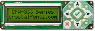

This display is truly a front-panel solution, not just an LCD module. Designed to fit in a 1U server enclosure, it is by no means confined to one. This display can drive LEDs using the GPIOs provided, configure headless servers, or, with the right software, be a wired remote for your home theater PC.
It has four directional buttons, an enter (check) key, and cancel ('x') key. Instead of using a corruptible stream-based communication protocol, it uses a 16-bit CRC protected packet-based protocol to communicate with its host, meaning that line noise, environmental interference, etc., won't cause the display to start any process on your host unless it was actually initiated by a user. Because both the keypad and LCD are backlit, this display is great for low-light conditions.
The CFA533 is backward compatible with the CFA633 for its communication interface, but has added features such as 3.3v to 5v operating range, ability to change the keypad backlight brightness separately from the LCD backlight, a stainless steel bezel, and a single supply voltage for both logic and backlighting. Voltage compensated single-supply 3.3v to 5.5v operation allows the module to easily work with a wide variety of power supplies. The CFA533 is the logical progression for any application already using a CFA633, but not utilizing the CFA633 fan functionality. With all its features, this display is perfect for the display and user interface of your next project that requires an LCD and keypad without fan control.

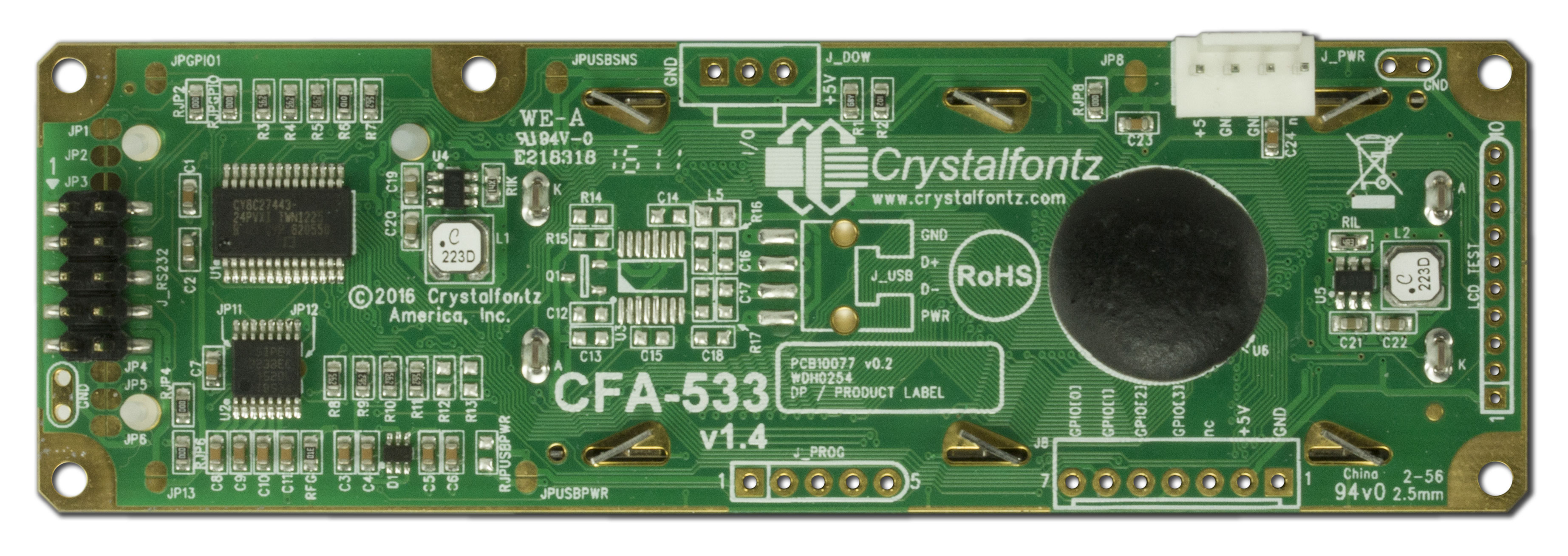

  • text_snippetPart Change Notice #10725: CFA533 serial and USB firmware revision 1.1 to 1.2
    Products Affected: CFA533-YYH-KS, CFA533-TMI-KS, CFA533-TMI-KU, CFA533-YYH-KL, CFA533-TMI-KL, CFA533-TFH-KU, CFA533-TFH-KS, CFA533-TFH-KL
    Date Issued: July 8, 2016
    Summary: CFA533 serial and USB firmware revision 1.1 to 1.2
    Last revision: 1.1
    Description: The CFA533 series of advanced display modules will be changing from the current serial and USB firmware version 1.1 to version 1.2. Firmware changes support hardware design changes; no functional changes were made or added. Firmware version 1.2 requires Hardware version 1.4 or newer.
    Reason: As part of our continuous improvement, firmware has been updated for use with updated hardware for the CFA533 series of advanced display modules.
    Serial versions (-KL and -KS suffix): "CFA533:h1.4,s1v2"
    USB version (-KU suffix): "CFA533:h1.4,u1v2"
    Recommendation: CFA533 firmware version 1.2 is considered a fit and form replacement. Testing of new firmware is recommended when the new hardware version 1.4 is available
    Availability: CFA533 hardware version 1.4 should begin shipping Q4 2016.
    Engineering samples for testing / validation of the firmware version 1.2 will be available during this same time frame.
  • text_snippetPart Change Notice #10724: CFA533 series Hardware revision 1.1 to 1.4
    Products Affected: CFA533-YYH-KS, CFA533-YYH-KU, CFA533-TMI-KS, CFA533-TMI-KU, CFA533-YYH-KL, CFA533-TMI-KL, CFA533-YYH-KC, CFA533-TMI-KC, CFA533-TFH-KU, CFA533-TFH-KS, CFA533-TFH-KL, CFA533-TFH-KC
    Summary: CFA533 series Hardware revision 1.1 to 1.4
    Last revision: 1.1
    Description: The CFA533 series of advanced display modules will be changing from the current hardware version 1.1 to version 1.4. Design changes were made for backwards compatibility. Hardware version 1.4 requires firmware version 1.2 or newer.
    Reason: As part of our continuous improvement, design changes have been made to the hardware of the CFA533 series of advanced display modules for improved manufacturability, improved quality, and a lower current profile.
    Impact: Factory default configuration has no functional changes. Standard and custom configurations are not affected by the new hardware layout. CFA533 hardware version 1.4 should replace the previous version of the CFA533 with no physical changes and is considered a fit and form replacement.
    JPGPIO1 -> RJPGPIO1
    JPUSBPWR -> RJPUSBPWR
    JP2 -> RJP2
    JP4 -> RJP4
    JP6 -> RJP6
    JP8 -> RJP8
    Solder jumpers are still in place for configuration after jumper resistor removed. Jumpers will appear open. Configuration changes not performed by Crystalfontz America, Inc. will need to make note of this manufacturing change.
    Recommendation: CFA533 hardware version 1.4 is considered a fit and form replacement. Testing of new hardware is recommended when available.
