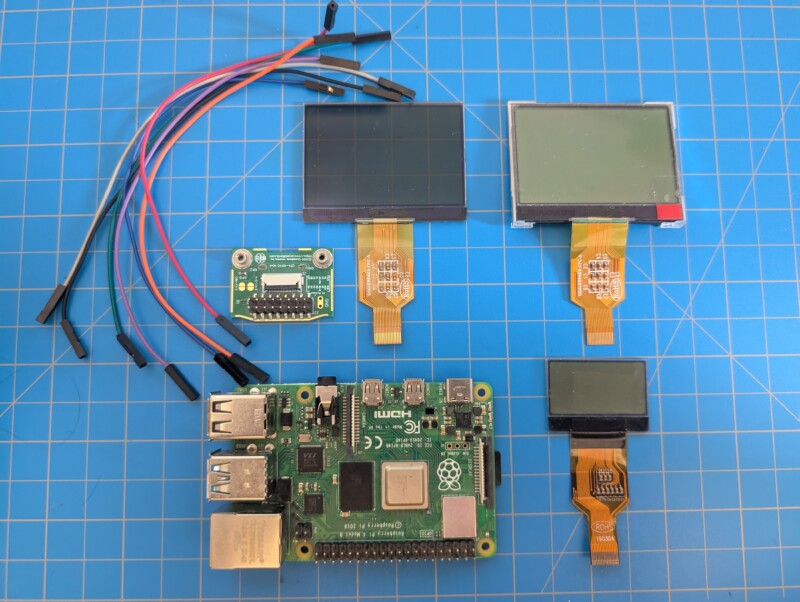

Supplies:
• A display with CFA10110 adapter board (see list of applicable LCDs below)
• Raspberry Pi (I’m using the 4B+) with OS loaded
• 5V power supply
• Jumper cables (e.g., 6″ WR-JMP-Y40 or 3″ WR-JMP-41)
• The demo code

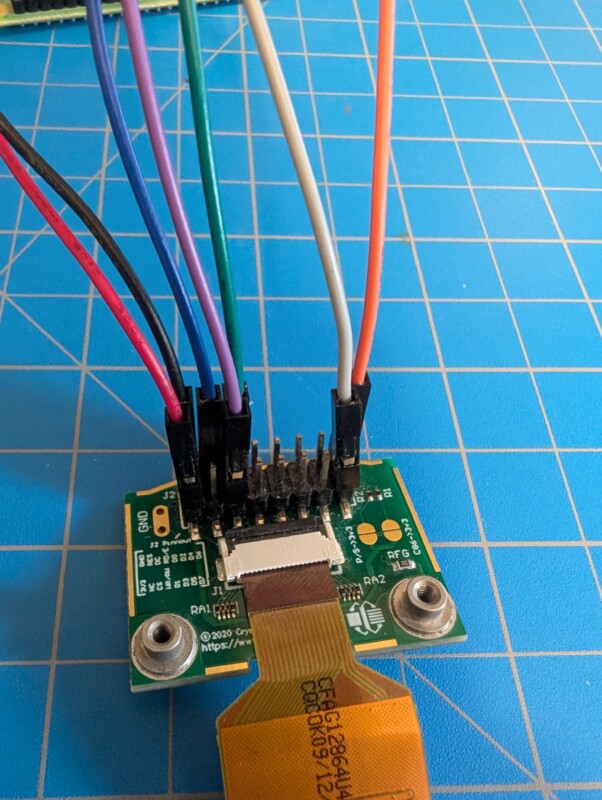

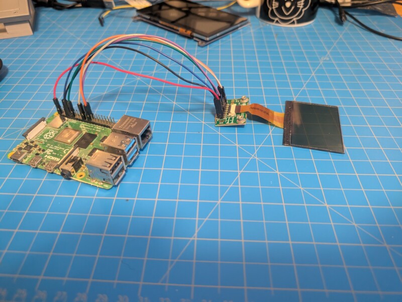

Wire the Board to your Raspberry Pi:
Using the jumper wires, connect the CFA10110 board to the Raspberry Pi.
In the table below, I’m listing the pin number on the 40-pin header (not the GPIO number). Refer to the Raspberry Pi pinout for GPIO numbers.
// RPi Pin | LCD | Color
// 3V3 | 3V3 | Red
// GND | GND | Black
// 11 | DC | Green
// 7 | RES | Blue
// 24 | CS | Purple
// 23 | D6 | Orange
// 19 | D7 | Gray
